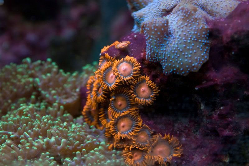

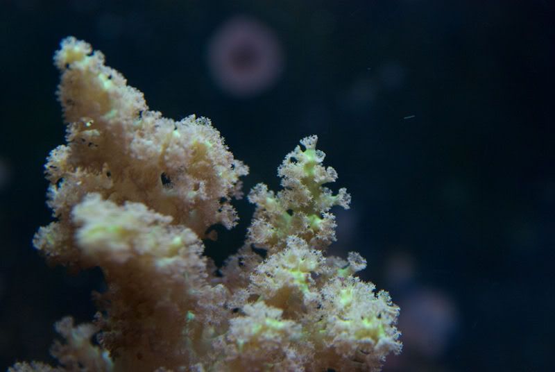

Here are 4 sample images taken with the exposure delay enabled. I am VERY pleased with the results, for taking about 5 min. to take them
Wow, I don't remember ever coming across that setting before....Thanks again all, you have really helped out alot!!
Awesome 5 minute shots! &... Awesome that you learned a new feature today thus enabling a few others to learn too.
