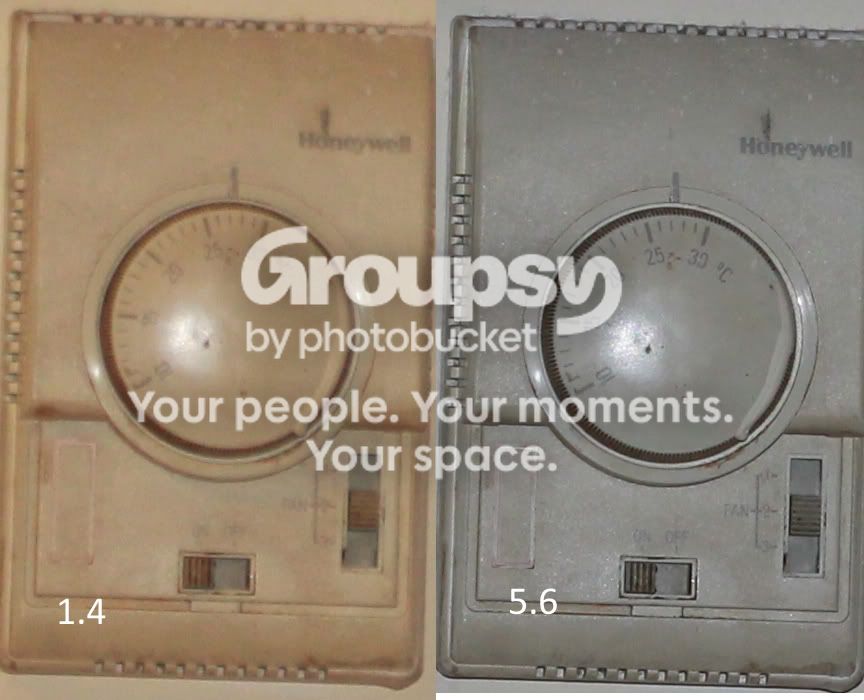

hi guys..
i have posted a couple of c&c photos earlier and i always got a comment that my photos are not sharp (were at 1.4 and 2.8).. so i have made the following comparision to share with you is the problem in all the 50mm 1.4 lenses or is it only mine?!
All those are at 100%corp and sorry if the size is a bit big but this is the smallest i could arrange
Thank you for your comments in advance.
Actually the real image is larger but this show the difference also..
All lenses are a little softer on the widest and smallest aperture settings.
I don't know if my 50mm f/1.4 is *that* soft at f/1.4... but it's a little softer than the middle apertures.
Most of the shots I take with that lens is at f/1.4 and f/2.8 because I'm shooting in dark bars/clubs, but I still feel that I can get sharp images out of it as long as my focus was good.
did you refocus? Or did you set it to MF and change all of settings?
Auto or manual focus? It's hard to tell, but it looks like the focus is behind the dial and also that the lower right corner might be sharper than the upper left. Sometimes it can be difficult to separate focus issues and the camera not being exactly perpendicular to a surface from inherent lens softness. If focus or camera position is off, then the image will not look sharp wide open, but as you stop down dof will begin to cover focus or position errors.

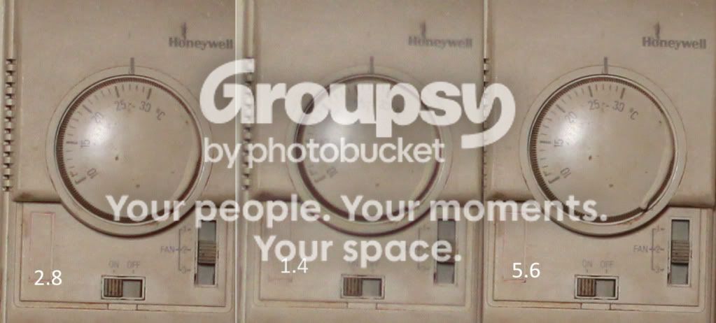

First I used the autofocus.. but your are right .. it should manual to insure the same focus.. so i set the tripod about 2meter far and and manual focused and took the same shoot at 1.4 and 5.6 .. and this is the result
:( really disappointing!
Its exactly same thing on mine and even on the L series 200mm, whenever you set to wide open aperture its a bit soft, i think thats normal

yes i did .. flash , 1/250 ,iso 100
Dude, if you want to compare 2 shots, you have to make everything the same :). Your wide open shot is without flash, and lower aperture is with flash. If you use a tripod, you can make your shutter speed really slow.

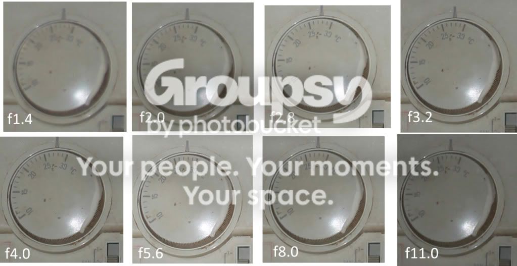

As promised.. here is the result without flash on a tripod ISO 500
Still i was expecting more from my lense, but 2.8 seems fine especially that it gives also a very nice dof .. where the whole face will be sharp and anything eles will be in the dof :)
Yup.. it looks like you need a new controller.. it is super dirty.
Oh wait, thats not your question? LOL
Samerr, you got to realize you almost never post anything with 100% crop. I mean if you post the whole thing.. i bet it looks sharp LOL.
