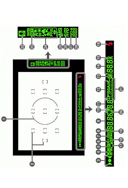

Nikon D2x in portrait orientation

The Nikon D2x had a 11-point AF system developed exclusively for the D2 series with the 1.5x APS-C sensor size, and it has what some call a "wide-area AF" system. The easiest way to use the D2x for action is to set it so that there are FOUR AF points in use at one time, in a "Group AF" pattern; the center AF patch is always used, then the three top AF patches also are used. In center-area, the center patch is in use, as well as the three surrounding patches. In real-world use, what this means is that the camera can absolutely NAIL FOCUS on "talls",even on running subjects or other fast-moving, off-center targets, and also, indoors in low light, the camera can simply lock-on the focus--where in the SAME lighting conditions, the 5D simply cannot be relied upon to nearly the same degree...especially with FAST lenses like the 50/1.4 or 85/1.8 or 135/2, shot wide-open and at indoor distances, or on moving targets.

BTW, most Nikon users of the newer cameras with the 51-point AF systems (D300,D700,D3 series) have found that 9-point "group" AF is the preferred way to get the most-reliable AF on challenging,moving subjects...which is basically, an area of the same size as the D2-series AF system used in its 4-patch peripheral or 5-patch center-weighted AF, basic "Group AF points" mode. Others prefer the 11-point group in the D300,D700,and D3 bodies..
