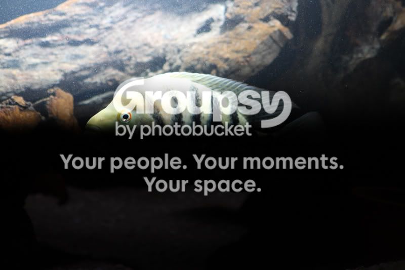

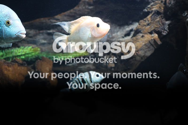

I returned my Canon XS earlier today and picked up a T1i to replace it. I am having a problem with it when I use a faster shutter speed so I was wanting to check and see if it was a problem with the camera or a problem with the camera holder (me).
Here are some sample of the pictures. If I use anything faster than a 1/250 I get pictures like this. Please don't mention the photo quality, I know they are terrible but they should still give you the idea.
Were you using the flash?
It looks like you were exceding the flash sync speed. (Probably 1/200th.)
EDIT
It's either that, or a sticky shutter - which is highly unlikely on a new camera.
Yes, I was using a 430EX II flash via a Cactus remote trigger.
That's probably it then. Your shutter speed was too high. The dark areas you're seeing are the shutter curtains - before they've opened all the way.
That makes sense. Thank you very much for the information. I am glad to hear that it is user error and not a problem with the camera. I am still new to this hobby so I am the first to admit that I have a lot to learn.
Yep, your shutter speeds were between 1/320th to 1/500th. The T1i max sync speed is 1/200th.
