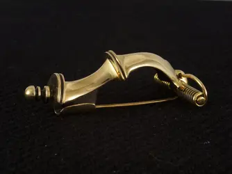

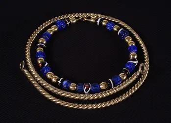

I am new to photografy. I am looking for advise or ideas about what kind of lens and camera should i purchase. I need a camera and lens for taking a photos of jewelry which i make.
I know that there are many similar questions on the web, but all of them focus specifically on choosing macro lenses. My jewelry is quite big, like necklaces, bracelets and big brooches, so i will not need a very close up photos. Photo should fit a whole necklace with a little space around it. I guess i will not need macro for that. But i need a very sharp view of objects. I will take photos of objects, placed 20 - 70 cm from camera.
It is very important for me to have really wide depth of field in the photo, so that it would be possible to have whole object in focus. It will always be shiny metallic objects on black textile fabric. Could someone suggest what kind of lens could fit my needs? This should be a sharp lens, i guess. Also i will need a camera, too!
I add an example of what objects will appear in my photos. This is not a perfect photos, (especially the second one- i want it to be sharp :) ) it is only to show what i am talking about.
i really like my sigma 105 micro, but for you, i suggest a shorter focal length for more DOF. my old 60mm nikon micro is not as sharp when pixel peeping, but will work better for you unless you deploy a couple of flashes so you can shoot at f22.
have you considered a wide angle micro?
I think you should go for a little wider angle but really you still need macro because they will look a lot better you could even try a straight 50mm and go to f18 which should be still sharp. And definitely use flashes

Just about any descent macro lens will work for this. To get that tack sharp front to back focus you need to learn a post processing technique known as "focus stacking". Go to youtube and search "Focus Stack" . There are many good videos on this subject. I like this one

Already tried to do focus stacking, just to see how it works: it works great! This is done from three photos. It should be more than three, but i just wanted to try.
Focus stacking definitely bthe way to go
