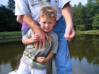

Apparently I have a combination of problems. Monitor calibration is one that I will rectify as soon as I can place an order, but it also seems that PSP X8 has a bug in color management which can cause a "yellowish tint" Found quite a bit of information on google while I was waiting at hospital today. I went back in my files and opened an old image in PSP - work space sRGB 16/bit to test (please don't fault me it's not a great image I was in a hurry), and did a few edits in PSP to force an image change (I had previously uploaded this to FB outside PSP with no issues) Then converted it to a sRGB 8/bit and uploaded to FB. The FB image was the same as PSP on my monitor, but the other devices (tablets and phone) all had a definite YELLOW cast. I converted the same image with same edits to an AdobeRGB1998 workspace, and uploaded to FB, it didn't make any change on my monitor, but now all the other devices were showing the same as my monitor with no yellow cast.
I closed out images, went in, turned off color management in PSP , rebooted my computer, then turned color management back on and set the workspace to sRGB. Reopened the original image, as an sRGB/16 made the same edits again, decreased it back to 8 bits, and uploaded to FB. Now all three devices were once again fairly close. I'm not sure how or why this worked, or if it will revert back on it's own, but for now, I think I can move on to monitor calibration without the "yellow glow", that was driving me crazy.

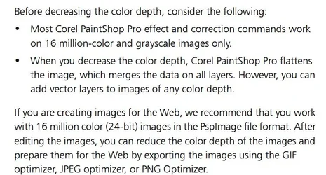

Interesting clip from the documentation that I found as result of all this

I checked this image and it looks good. Most importantly it has it's EXIF data intact and carries an appropriate sRGB ICC profile -- as it should. Skin tones are in normal range.
Phones and tablets are not calibrated devices and should be expected to show color incorrectly. If all three: computer, phone, and tablet were the same I'd be alarmed.
Adobe RGB is inappropriate for your use and should be avoided.
I suspect that's old. "Most Corel PaintShop Pro effect and correction commands work on 16 million color and greyscale images only."
Certainly that is not the case with my version of PSP which works just fine with 16 bit files.
The paragraph about creating images for the Web comes straight from 1995 and should be ignored today as ridiculous. There is absolutely no reason to create indexed color photos for web display today in 2016. A graphic, sure, but not a photograph.
