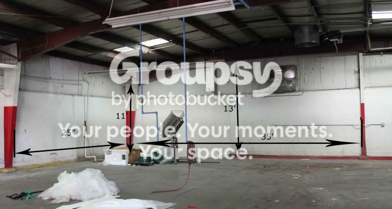

I need to create a cyc wall at the company I work for so we can take product pictures with infinity backgrounds. Unfortunately I have had very little experience shooting pictures inside a studio. We cant hire a professional studio do to the fact that once on of our product are finished it literally has to be crated up in 3 hours. So I need all of your help to guide me through the murky waters and point me to the proverbial light. So i guess I have three main quesitons:
  1. How to properly Light the cyc wall?
  2. $$$ of lighting the cyc wall?
  3. What size to build the cyc as well as what angle to curve the corners?
Construction will not be a problem as I will have a contractor build the wall. I have attached pictures to give you an idea of what I am working with.

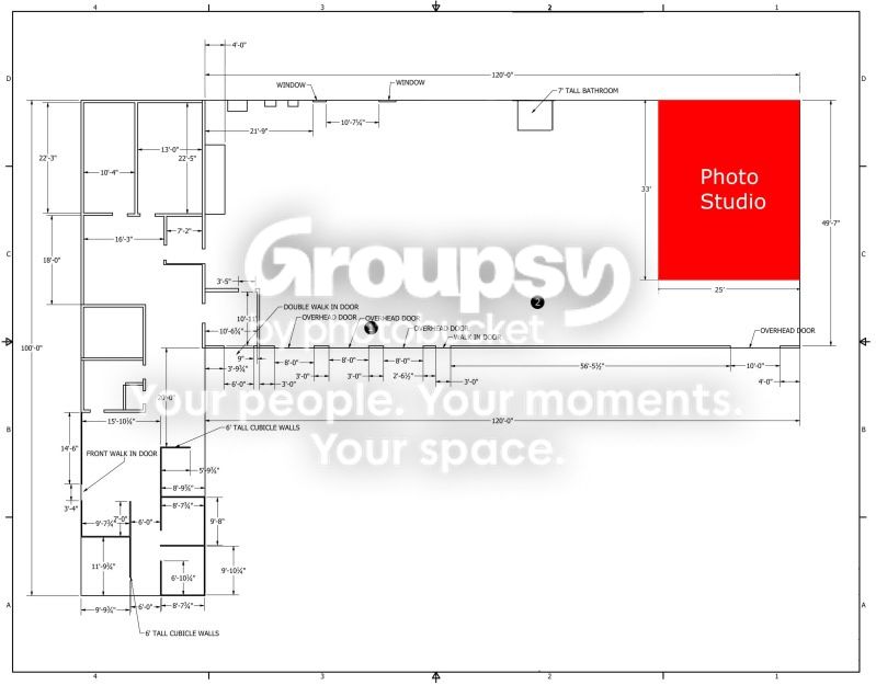

1. This is the overall floor plan of the place I work. Note that the photo Studio is (33' x 25') Also the black dots with number indict the position of the next two photos. I am thinking of building the cyc in one of tow places the 33' wall or wrap it from the 25' wall to the 33' wall. I am a little concerned with second option because I have very little skill in lighting and it seams that lighting would be a nightmare.

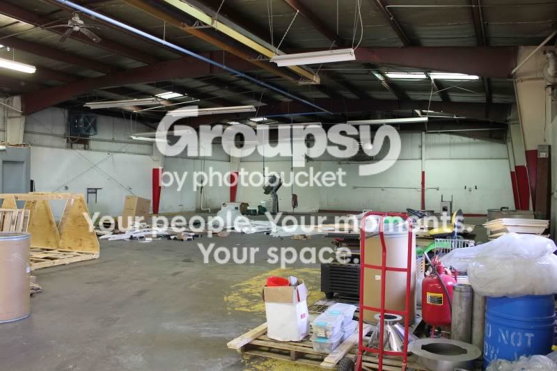

2. This picture is just to give you an overall perspective of the general area i have to work in.

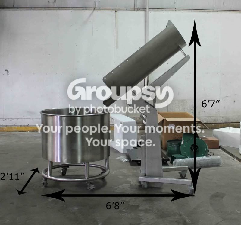

3.This better shows the scale of the area i have to work with. The stainless steel drum tipper in the center of the picture is 6' 7" tall. This should give some perspective.
4. This shows what the average product photo will be of. Please not the size.

Small disclaimer...I am a pro videographer and know lighting cycloramas very well. The same techniques should apply for photography but there may be other methods out there. All my lighting knowledge is continuous lighting. (I plan to learn flash usage soon)
After renting studios for years I recently built my own 12'x9'x9' cyclorama wall. Quite a chore! Your space will be quite a bit bigger (unless you decide to shrink it to save money on lighting!)
There's many ways to build the curves. I chose to make ribs like an aircraft wing which support 1/8" plywood to "skin" the curves. My curve starts 3' up from the floor and runs out 3' onto the floor.
Use drywall compound to cover your entire surface area as its easy to sand. Transitioning from wood to drywall isn't bad...wood to my concrete floor was tricky and I used Bondo as it's super strong once dry. Sanding and smoothing is the hardest part. With the size you will need to build it's gonna take a while.
Lighting won't come cheap depending on your choice of fixtures. I actually built my own Kinoflo style 4- bulb (220watt total) heads. They are fluorescent daylight balanced bulbs. They are the equivalent of 880 tungsten watts and I needed 4 to light my space. 2 for the wall and 2 for the floor. Nice thing is they don't generate much heat and are cheap to run. If I had gone with Kino or Arri or other companies those 4 lights would have been close to $6k. I spent $1600.
My lights hang from a grid I made from 2" steel tubing. All fixtures are hung with pro grip gear and safety wired. Rule of thumb is point the lights at a 45deg angle down and put them half the distance away from the wall as the wall is high. (in my case they are 4.5 ft back and 9 feet in the air (the height of my wall)
Here's where it gets tricky...based on the dimensions of your space, you need to calculate the throw of your fixtures and beam spread to know how far apart and how many fixtures you need to cover the area. Fluorescent doesnt have nearly the throw of tungsten and the fixtures are more expensive so for a large area may not be economical. If you went with a tungsten fixture, you could hang it higher which would increase the coverage area but require more wattage thus generating more heat. They are less money upfront but remember the bulbs have a short life compared to fluoros.
The largest room I've shot in was 40'x40' walls with a 25' ceiling. The lighting for the walls was all 2000watt Mole Richardson tungsten heads placed every 10'. They were on a grid 25' up and about 10' from the walls. There were 8 fixtures. For the floor they used four 6' China ball fixtures. That only covered the area of the floor we were using. I'd imagine to light the whole place up would have needed double that. Not sure but they had to be at least 1000watt each.
When I shoot stills on my wall, the only thing i change is the subject lighting. My wall and floor are constant which makes life easy. (also note that most of my work is green screen video. I do put up a white or blue background every once in a while for stills and the same lighting works perfectly.)
The best thing I can recommend is visit your local video studio that has a permanent cyclorama wall and take note of how they light it. TV stations sometimes have studios too. All my ideas were "borrowed" from time spent in other people's studios.
