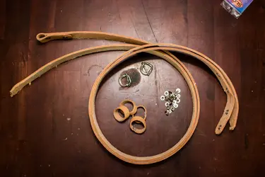

Items:
2 Leather belt blanks
2 belt buckles
2 leather belt keeper
1- Chicago screw
Camera slider
Leather dye

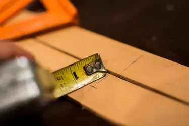

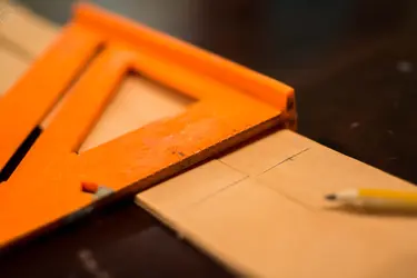

Cross the buckle end of the belt over on your back and find the spot that will work best for you.
Mark the center of both belts where they cross. You will drill this and hold together with a chicago screw.
Now drill the hole. (Reference drill bit size to the size Chicago screw you have.)

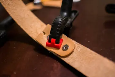

Now fasten the belts together

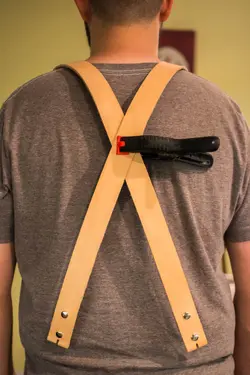

Take the harness and put it on your shoulders. Wrap the belt around as if you were going to wear it and clamp the ends together to make a reference point for the center belt hole to be drilled
Then mark the other holes and drill.
