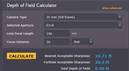

you can also consult a DOF calculator to determine what your DOF was at that distance to determine which of the two above could be the issue without testing.
