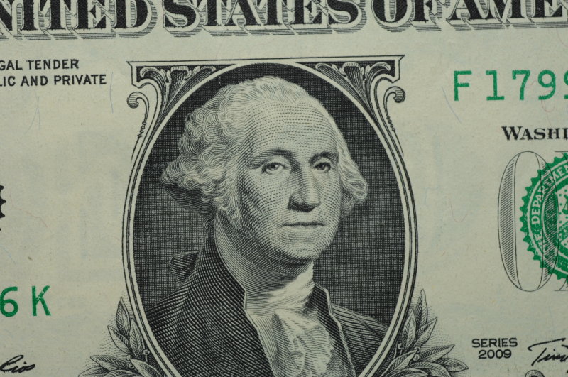

[FIRST TEST FRAME: 60mm macro with Nikon 6T reverse mounted on lens, focus set to 1 foot. Full-size SOOC JPEG at http://www.pbase.com/image/156051589 ]
[ SECOND test frame Nikon 60mm AF-D focused at 1 foot. Full-size SOOC JPEG located at
http://www.pbase.com/derrel/image/156051590 ]
[THIRD test frame,60mm macro with Nikon 6T reverse mounted, focus set at MFD Full-sized SOOC JPEG at http://www.pbase.com/derrel/image/156051591.jpg ]
[FOURTH test frame.60mm macro AF-D focused to MFD. Full-sized SOOC JPEG at DSC_7271_60D at MFD.JPG photo - Derrel photos at pbase.com ]
Maybe you can see that at longer distances, the + diopter lens makes a significant difference. At MFD however, the lens has lost some effective focal length, to the extent that the Nikon 6T + Diopter lens has very little effect on overall magnification! When it comes right down to it, I look at the 60mm Micro-Nikkor as a lens that was really designed to copy FLAT artwork and documents, from a foot to ten feet distant, and NOT really as a lens that's ideal for close-in shooting of small subjects. The working distance is really VERY short with this lens. I greatly prefer a much longer macro lens, like a 90, 100, 105, or even a 180mm macro lens.
