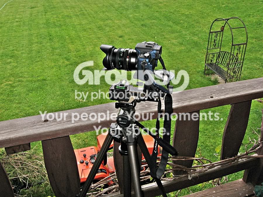

Here is my set-up, I used macro focusing rails to get the lens front element as close as possible over the point of rotation. It is a little out front however.

2. I never ran into a stitching/overlay problem using the regular mount plate for my tripod. I like your rig but I think in your case it's overkill. Your subjects are so far away that it doesn't matter if your panning perfectly on the axis of the pivot point.
In my experience it would only be necessary to use your set-up if you are making a pano of something where you have subjects also very close to the camera. There you have to have a pan exactly on the pivot point to prevent alignment issues.
