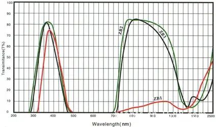

Unfortunately, it's a long way from here to suppliers of useful filters. Colour filters are available as are some IR. However, cut filters are hard to find locally and I've had to place orders for deliveries from 10-15,000km away. I hope to have some of those in the next 2 weeks. I've also ordered a couple of very interesting 'Pass' filters for UV and IR. One passes lots of UV and just a little IR while cutting out most visible light and the other passes about the same amounts of UV and IR but also blocks most visible light. The amount of visible light they DO pass, should allow for some extra false colour. Light frequency maps below. Not silly money from a Chinese supplier: NZ$103 for 2x 67mm filters incl freight.

I think those UV pass filters are clones of Schott or Hoya technical glasses. I managed to get U330 & U340 through work as 25mm bare discs. (U360 wasn't available at that time).
They can give interesting results but performance varies widely depending on factors like the nature of the daylight & the lens used. The small size of my filters isn't such a bad thing for UV as wider lenses have more glass & glass absorbs UV.
You're quite right I'll try anything & (almost) everything.
Having a spectrometer at work enables me to produce spectra like those you copied for any of my filters. This has shown me that sometimes filters that are supposedly the same can vary considerably in their IR characteristics. I have 3 Tiffen #58 filters (Green) one of them transmits loads of IR, another hardly any and the third is roughly half way in between. The intermediate one works very well with my SD14 cameras to create a aerochrom look SOOC (the foveon sensor shows IR as red)

Yeah, I don't know what they will do for me but as long as it offeres me other ways to be creative and different: I'll figure it out. I also have a bunch of 'red' filters that all give different results. A spectrometer would be awesome and, if I had one, I would label each filter for easier selection; lucky you!
