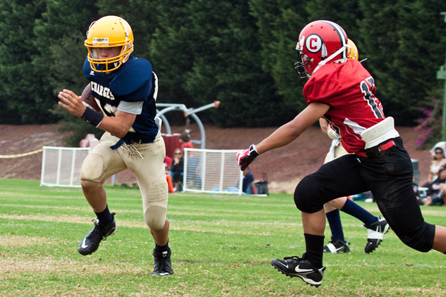

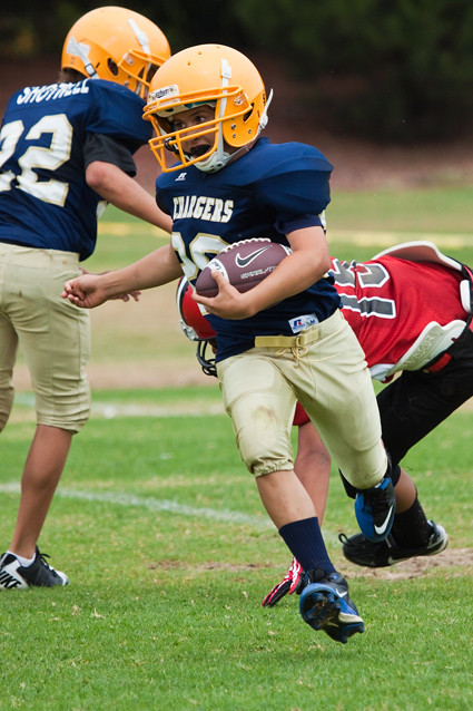

Dude your shutter speed is kind of slow to capture the action. You need to be up there around a 1/1000... Check these out.
IMG_1755 by J2Chargers, on Flickr
IMG_1838 by J2Chargers, on Flickr

Most field sports action shots are made with the camera held in the vertical (portrait) orientation, not the horizonytal (landscape) orientation, becuase people are tall and narrow, not short and wide.
The first 2 photos are amenable to the horizontal camera prientation, but the 3rd one isn't.
