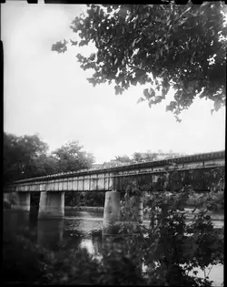

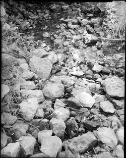

I've done a little large format before on a lark, but borrowed a friend's camera and he developed them for me. But now I got myself a Shen Hao and some 4x5 Ilford 100 and set up my own bathroom dark room. Best shots from the first run of a dozen or so sheets in my first couple runs. Last one is kinda messed up, but otherwise, surprisingly not ruined:
This is a lot easier than I expected it to be. Need to stop down a lot more in the future with my old old lens.
And yes I know the horizon is slightly tilted in a couple of them. Just posting more or less straight out of dark room.
Looks like you have wayyyy too much soap in your "Photo Flo" solution!
Cool beans though, Gavjenks!
Hm, I actually used legit wetting agent, and followed the instructions drop for drop with measured ounces of water.
I think it has more to do with my usage of plumbing pipe/DZTC style tubes. Developer seems to be getting trapped behind the negatives on the walls and not flushing out correctly, or something. Maybe I need to pre-wet them before loading, or load them submerged in water or something. I'll try less wetting agent than is recommended too, though.
Yeah...the dilution instructions on wetting agents are pie-in-the-sky....almost always wayyyy to concentrated, and they leave residue. I think it's a matter of needing to, some day, sell that customer his or her "second bottle of product". My normal practice is to mix it up as stated...THEN, pour at least 50% more new water into the wetting agent tank, allowing the stuff to just overflow. Also, it "seems" that wetting agent is less prone to leaving residue after a full day of sitting after mixing.
