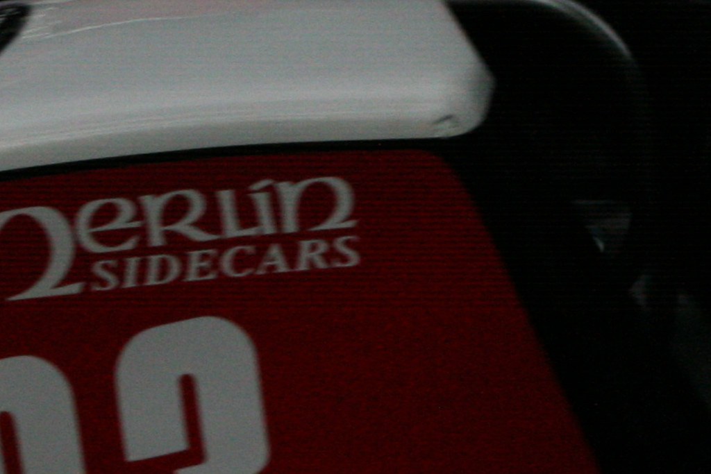

I started photographing bike racing -
Under certain circumstances I come across "lines" showing especially at black areas and some times forming stripes of lines .
What am I battling with and how will I solve this problem ?
Hmm how about exif data...or just some ISO, aperture, shutter speed. Looks like video sync lines!
  1. This photo is under exposed, which accents electronic image noise.
  2. When a photo is converted to a JPEG the conversion process divides the photo into 8 pixel by 8 pixel squares. The lines look to be involved with that.
This photo is also badly underexposed and the electronic noise is self evident on close inspection. The soultion to your problem is to properly expose the photo when you take it.

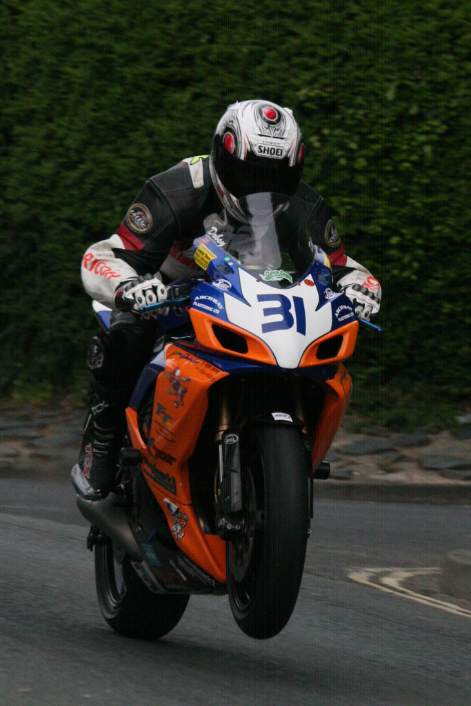

However, a nip here, a tuck there:
and another with about 12 seconds more work:
