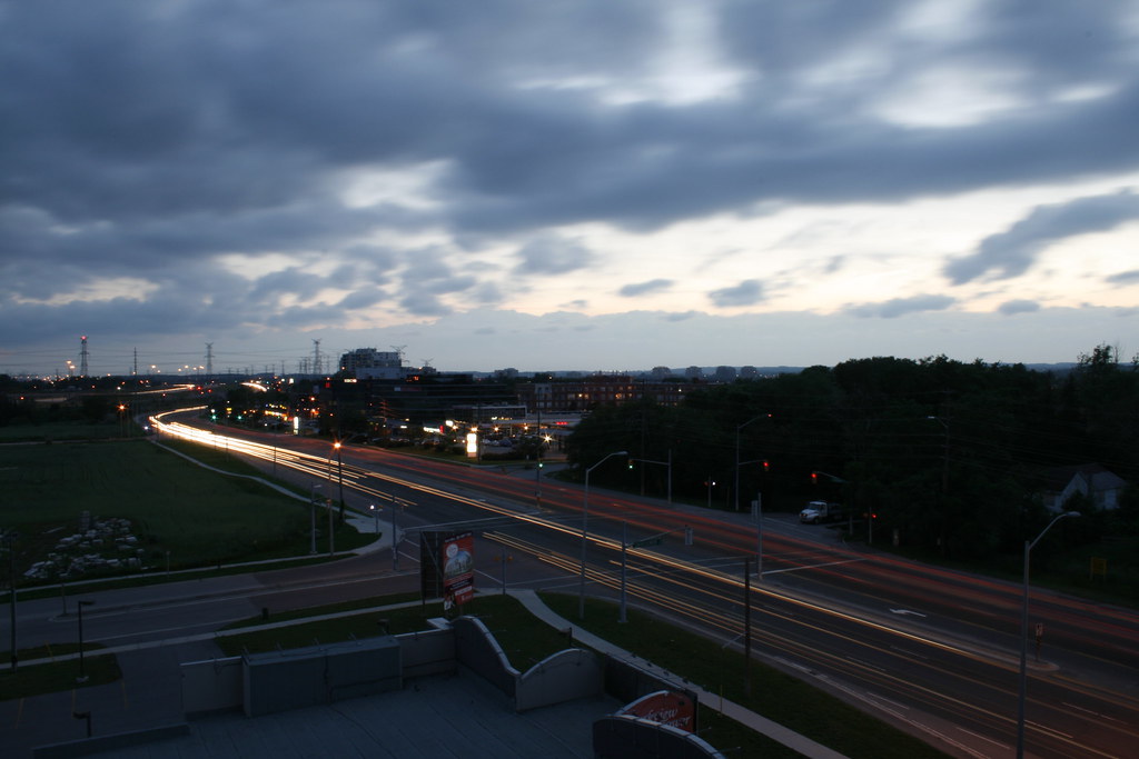

just did some shooting on my balcony .. C and C please
i thought the photo looked kinda dark, it was shot @ 8" and F22 w/ ISO 100
oh an a question, what do i have to do make the photo comes out sharper (other than getting a new lens :greenpbl:)
Thanks
C&C welcome

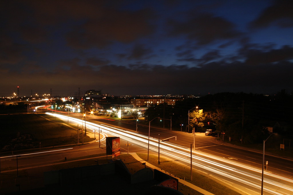

2nd one looks best.
What iso were you using? looks a little noisy at the top. Could be fixed in PS though.
I am under the impression that f/8 will give you the sharpest image across the widest depth.
Also looks like you could crop the top off too.
2nd one looks best.
this is the properties of the first shot
Exposure: 10 sec (10) Aperture: f/22 Focal Length: 18 mm ISO Speed: 100 Exposure Bias: 0/3 EV Flash: Flash did not fire
i think it is noisy becuase of the aperture
and the second
Exposure: 8 sec (8) Aperture: f/11 Focal Length: 18 mm ISO Speed: 400 Exposure Bias: 0/3 EV Flash: Flash did not fire
Not necessarily. Most lenses' sweet spot is somewhere in around f/8 to f/13 or so, but the "widest depth" will always be at the lowest aperture. (f/90 on LF, anyone?)
Then there's diffraction...
*sigh*
AND OP: The noise is due to long shutter speed (or high ISO, but not in this case), not aperture.
