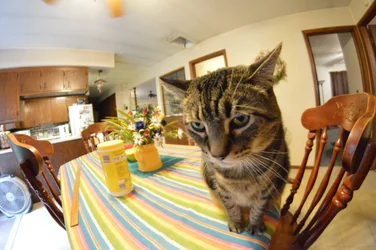

You need to physically change the aperture on the lens. Turn the aperture ring.
That seemed to only make the pictured worse... :(

What number did you turn it too?
Turn it to the smallest number.
I set the top number to 5/1.5 and the bottom to 3.5... its pointed at a very bright light...
Aperture -
Bigger the f number the Smaller the aperture thus the less light that goes through the lens, but the greater the depth of field
Smaller the f number the Bigger the aperture thus the more light that goes through the lens, but the less the depth of field

The Aperture Ring is the lower of the two rings (the one closest to the lens mount/camera body). The more forward ring is the Focusing ring and the numbers marked on it are the focus distances (in meters and feet with the sideways 8 being infinity focus).
Try stepping outside. Is it daytime where you are?
Ill definitely check into that book you recommended. Its 6:30 pm so there's still some light out. Just for clarity, is the aperture ring above or below the part that says Fish-eye cs?
I think you need to get the basics of exposure to use an ALL manual lens.
It's below. That 1.5 is your focus distance. The top ring is your focus and the bottom is your aperture.
I gotta say, you are my favorite person right now! :) The subject in the photo wasn't very cooperative, but I can actually see it! Thank you sooo much!
