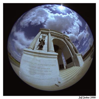

See in these shots how the corners are black, that because a true fisheye has a 180 deg symmetric view and that produce a round image, my 1D MIIn has a crop factor of 1.3 so you do not see the circle it will be even less on your camera with the 1.6 factor ,My 10d has a 1.6 crop factor I'll try to take some test shots tonights
3 fully un-cropped shot of the Sky in NY

edit: Jeff, i was aware of that issue. I didn't understand the question. The black corners/not full circle don't bother me so much. As long as the fisheye effect is still there (which it clearly is) then I'm unbothered.

Sigma 8mm f4 EX fish with 10D 1.6 crop factor
4
one more this time with film
