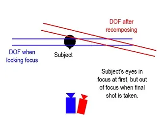

2. Yes. However, if the camera settings allow for a sufficiently deep depth-of-field (DoF) the belly button may be in focus too.
Another consideration is that the the area of acceptably sharp focus is a plane (DoF) that is essentially parallel to the image sensor. If you tilt the camera up/down or turn side to side, that plane of acceptably sharp focus moves with the camera and stays parallel to the camera.
You can think of it as a transparent, weightless, wall that is attached to the camera.

The focus and then move method is more convenient, but if you have a razor sharp depth of field, you may end up with an out of focus subject, because rotating your camera to recompose actually tilts your focal plane a little bit, and it can cause what was in focus to not be in focus anymore. Diagram:
In such a situation, you would probably be better off using a side AF point and not moving the camera in between focusing and shooting.
Alternatively, you could focus, recompose, then LEAN BACK a few inches or so depending on how far away you are, then shoot. I have done this sometimes in order to have the convenience of center point but without the missed focus... but it is kinda sketchy and not as reliable as the side AF point obviously.
