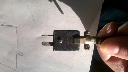

I've found an old Fujicolor Lucky 60M-C Enlarger for my soon-to-be darkroom and i have a small problem:
I can't tell (and apparently neither can Google) what kind of plug it has.
Can someone recognise this plug so i can run buy an adaptator ?
Thanks a lot.

That is a "Jones Plug". It is designed to plug into a power supply and should NEVER be connected to the mains. I would imagine that it was designed to be plugged into a dedicated power supply and some sort of timer or foot switch.
Hey Alex,
Thanks a lot, I've just found out that I can plug it in a fuse box and connect this one to the timer.
Everything looks like it's working good.
