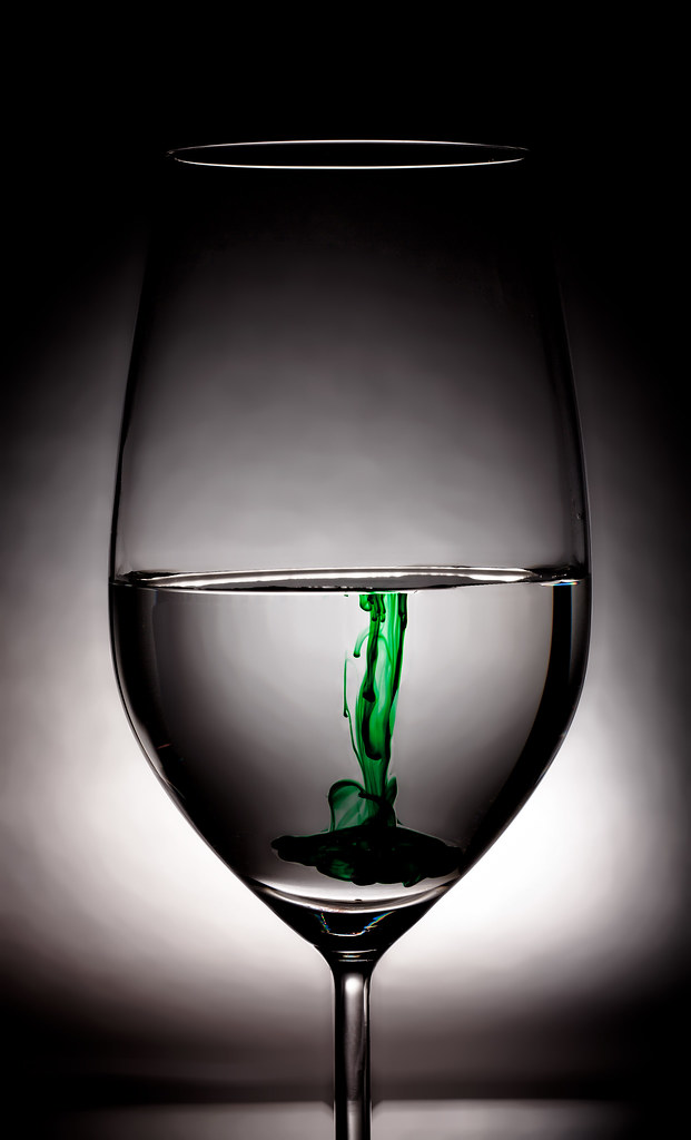

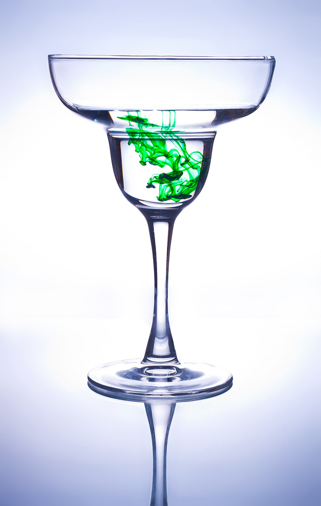

I was having some serious issues using paper as my white background. The texture of the paper kept coming through. I guess I need to use fabric instead of paper?
I took 100+ frames and kept 5.
#1
IMG_1071 by Lyonsroar91, on Flickr
#2
IMG_1108 by Lyonsroar91, on Flickr
#3
IMG_1070 by Lyonsroar91, on Flickr
Anyone have anything to say?
:thumbup:
Did you happen to get a shot of your lighting setup? The end result is really neat, nice work! I like #1 the best, although the exposure could be up just a tiddly.

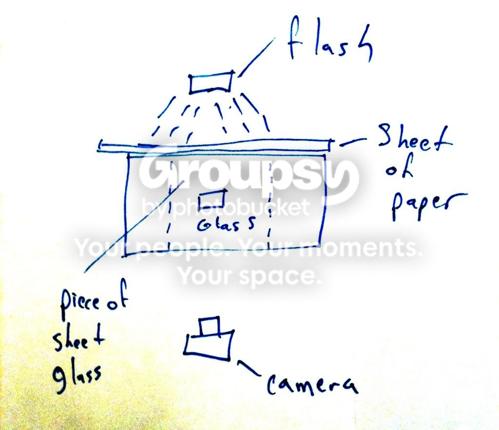

Like every time, I didn't even think of it until I was breaking it down. Good thing it was crazy simple.
You pick a good color. Now you can experiment and mess with the green channel and change the hue to change the color to whatever you want.
The texture of the paper was showing because the paper was way to close to the glass. That put the paper inside the DOF for your setup.
I figured that was why. I experimented moving the glass towards the camera and away from the paper, but then I got background on either edge of the paper showing. Not a big enough background.
I'm going to pick up a large piece of white fabric today and we'll retry this. I was happy with the results for the first time trying something new though.
Thank you for your input.
