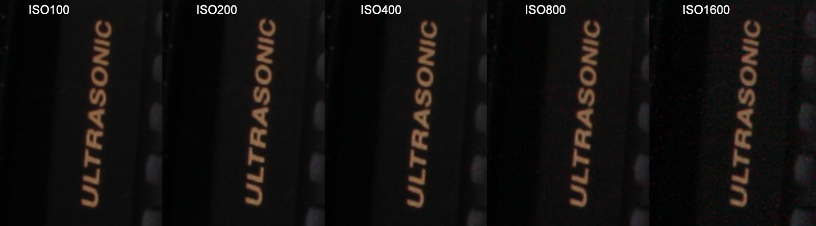

I have now created my first guide, this is on ISO-speeds and how they affect your photos.

I still think you're overplaying the storage space and battery drain aspects here - considering the price of memory cards and the fact that you can easily take several 100 shots on even a 4GB card when shooting JPEG and even in RAW you can get 100s out.
Also your series of shots that you show here is suggesting that the image quality gets sharper as you use higher and higher ISOs. Your ISO 100 shot above looks significantly softer than your ISO 1600 shot so either your aperture or your focus point has shifted as you have taken the series - giving people a missunderstanding.
Furthermore in your article you start to talk about ideal ISOs and shutter speeds, however you make no mention that the relationship between those shutter speeds and the ISO that you have used is linked directly to the lighting that you had at the time for those shots and the fact that you were tripod shooting. This makes the advice pointless for any other situation outside of the single example you present.
In addition you've overlooked the fact of shutter speed in relation to motion blur of the subject itself, you mention blur form handshake, but not from a moving subject - which is often a primary reason to raise the ISO to get a higher shutter speed.

But if your high ISO 100% crop is showing sharper quality than your low ISO 100% crop then your article is working against your overall intentions. Also by limiting it to an indoor product shoot in lower lighting you've skipped over all the examples of possible situations where using a nice low ISO 100 is going to give a good sharp result. In fact you almost advise against low ISO by showing those example shutter speeds and ruling ISO 100 out so fast.

For your example pictures, something where the majority of the frame was not BLACK would have worked much better. You can barely even see the noise.
Use something that's going to actually show the differences in noise levels.
In your other example picture, they're just too small to see anything (and there is still a lot of black).
As it can clearly be seen, the ISO100 to ISO400 are pretty clear, but anything higher than that, gives a lot of noise.
It cannot be clearly seen...
