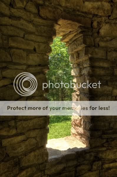

I'll play along and show how I would process the image. Now it's coming down to personal taste. I would want to show that it is a little darker inside the stone building:
I see the sill and arch way of stone is now very magenta colored. The grass is very dark lush Irish Green that everyone would like to have but is seldom seen in this area Im betting. The yellowish tone you see in my version I was aware of. But Ive been in similar rooms as this in the past and I feel that the yellowish cast comes from the rocks themselves. If Im not mistaken the colors are fairly accurate. Of course with all our monitors and uploading and dowloading files from here to there and back again we will never agree on color. But sparky should be able to comment on which colors are more accurate from his memory.
And I never said that the lighting couldnt be done any other way than HDR. Im sorry if you mistook what I said. With some elaborate setup you could duplicate the HDR results perfectly. I see the pic has 3 primary lighting areas -- the forest and grass, the strong sunlight on the sill and the shadowed room. You can use the camera to exposure for any one of the three. You can use the flash to bring up a second. But there will still be a third which needs fixing. So is it possible to shoot all three areas with a single flash?

The green in the EV0 shot is very close.
My interpretation.
