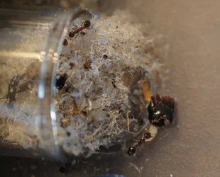

here is the picture I took with it. How can I get a bigger closer picture of em?
Thanks

I'm not familiar with that lens but how close have you gotten to the ants? I'm assuming since its a 30mm you have a very small working space - meaning to get a true macro shot you need to be right on top of them. Like a few inches away, or closer. Just get as close as you can and the camera is still able to focus.
"How close" you get isn't an indication of magnification. Two different methods can have the lens the same distance from the subject yet they will produce totally reproduction ratios. The key is -reproduction- ratio. 1:1 means the subject is projected on to the film/sensor at full size.
2:1 means the subject in the image is twice as large as the subject itself. So if your fil/sensor measures 36mm, an 18mm object will cover it.
You can create a condition where the focus point is -inside- the lens, making focusing a bit difficult... not to mention lighting.
Here is a shot using a reverse ring on a D7000 and 28-300mm Sigma. The ant was actually smaller than the ant in your image. The image here is made up of 8 or 9 images which were focus stacked. Even under a magifying glass I couldnt see any details on the ant. It was still too small. I was amazed when the final image came out showing the amazing detail like the texture on the exoskeleton. When getting this close the depth of field is non existant so many shots are needed to cover the total length of the tiny ant. The image is not cropped and is full size.
Thank you all for the helpful tips. Truly you have helped me a ton. I liked the 5x nanoha, wow. The tip about moving the camera on top of the ants was good too megan. I didn't realize you could get that close. I guess now that I have the macro lens if I want bigger picture I am going to have to get some extension tubes, better lighting and close up filters. Here is what it looks like if I put the camera right on top of the ants:
wow bynx that is impressive. I am blown away, what an amazing picture. Thank you for letting me know how you did it. Now I know what to aspire to :)
