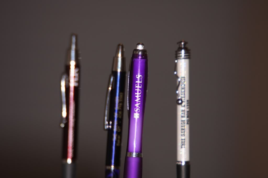

Have you done any controlled indoor tests with your lens. Here is why I ask...I own a Sigma 50-500 that gave me excellent results. I then bought a Canon 600 f/4 IS and loaned the Sigma to a friend. His camera body and my Sigma when paired together suffered major front focusing issues. What can happen with tolerances is this...say the lens focus right at the front of a subject but is within tolerances. Works fine on most camera bodies. Say a different camera body is within tolerances, but also at the front of the tolerance range. Now paired together, they front focus a tad. Easiest way to determine this is a tripod mounted test indoors with mirror lock-up and either the self timer or a shutter release cable. I found it useless to do the whole print test sheet, 45 degree angle thing. Hard to do on a long lens with a long minimum focusing distance.
Here's what I did... a got a cardboard box and stabbed 4 ink pens in it. Each pen is about 2 inches behind the one in front of it and staggered so that all can be seen. The paint diagram illistrates this from an over head view, and is color coded to the ink pens in the test shot. I took the shot at around 20 feet. Focused on the 3 pen back and with my camera body, focus was spot on.
Here is how the lens focused on my friends 30D.....bad front focusing.
Not sure if this is your problem, just throwing out an idea here.

I did a couple focus tests last night and I think in regards to focus distance things are OK. What I did find however is that if the light is not good I cannot get sharp focus with my xti no matter which lens I use. The sun went from bright to setting as I was playing around. As soon as the light level dropped my captures went blurry and no matter what settings I tried I could not get them sharp. I also tried my external flash with no success at 20'. This somewhat matches up with things that I have been thinking, in my original post I mention lighting. A coworker brought me his 30D to do some comparisons with.
