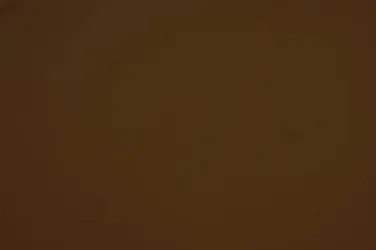

took some photographs today and noticed that i had some squiggly lines come up on some of them, I used a prime lens for most of my photographs today and haven't noticed them but when I used my 'zoom' lens 70-300mm they appear?? does anyone know what they may be and suggest any help i can get to remove them. Thank you in advance

also, forgot to add that i done the white paper test and these lines show up on both lenses ;(
That's odd; if the dirt pattern is identical regardless of lens, that pretty much only leaves the sensor, but that seems too well focused to be on your sensor. Have you cleaned the front & rear elements of both lenses and looked at them carefully under good light to ensure they're clean?
Time to clean your sensor. It's really dirty.
No, but really that's all it can be. Showing up on two lenses eliminates the lens, and as you said that only leaves the sensor.

Ok just took 2 quick shots rubbish lighting indoors but def. showing on both lenses, first is the 1.8/$8648_10151605332736236_715117749_n.webp$971975_10151605332751236_1288467160_n.webp50, 2nd is the 70-300
thank you, will be purchasing the items you have mentioned and will clean myself at least it will save me the time and trouble of finding a good camera shop i can trust ;) xx
