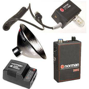

It's been awhile since I did any event photography or weddings, but I did my share back in the film era. I used one of these:
Attached to the predecessor of one of these:
I didn't have any TTL or similar electronic assist, that flash just had three settings of full, half and quarter power and the rest was up to me.
