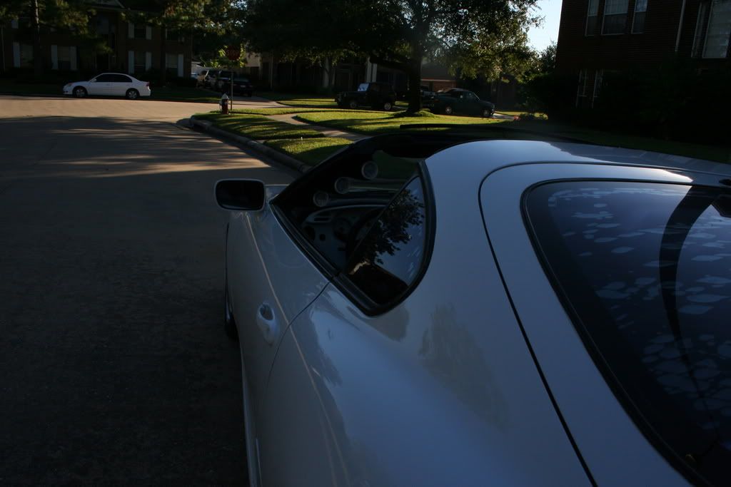

and lately none of my HDR images have turned out well. the settings are the same on the camera as they used to be. but all my pictures turn out grainy. In M mode i set the iso to 400 and AEB to -2, 0, and +2. Tommorow i'm going to try iso at 100 and see if it makes a difference. I've tried photomatix, FDR tools, and Qtpfsgui. but i can't seem to get results i like.
i was wondering if someone could take three of my pictures and make a nice hdr image out of them. I'm curious if i'm doing something wrong or if i need to change the settings on my camera.

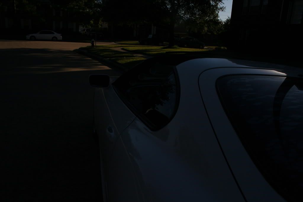

here are three images i would like someone to use, if you don't mind.
Thanks for your help! :mrgreen:

ya you have to keep the iso low not matter what. I tried to make a hdr out of those pictures but with no luck. It seems like the exposures are to close together even though you said you did -2,0,+2. One should be fairly overexposed and one fairly underexposedand one the proper exposure. To me it looks like you have one almost the proper exposure and two darker. Keep us updated on the shots you take at iso 100 or iso 200.

Thanks for the help, i noticed that too that pictures seemed to have one of the correct exposure and 2 darker, is that due to my ISO being higher than it should?

You are shooting into the light, and the meter is fooled into under-exposing. I think you need at least one more over-exposed shot in the above posted set. You will get even better results with HDR using 5 or 7 bracketed shots than just 3.
I'd say the noise is coming from the underexposed shots. Noise shouldn't be a problem at ISO 400 when properly exposed, and whenever you combine multiple exposures it should lessen noise issues. The grain is different in every exposure, and when it's layered together it cancels out some of the noise from other layers.

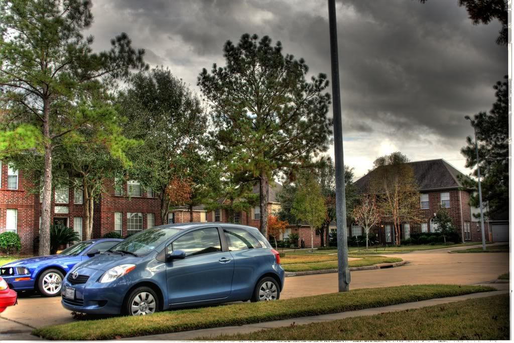

Here's a few HDR's i did with 100 ISO and i want to say like 4" aperature in av mode.
I really like the way they look, but it seems like no matter how hard i try i can't get it to look as if i was seeing it in person. It always just looks surreal, which i kind of went on the deep end with these since i couldnt get them to look like they should.
it was kind of overcast today which could've lead to the dark clouds
If u want a "real" look when you are tone mapping put the light smoothing in photomatix on the highest setting that will help. Its the 3rd slider i believe in the first section of photomatix
