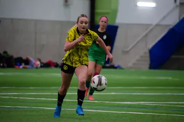

what would you say the camera is focused on here in the first picture? The mans face? I do have a lot of pictures that turn out pretty good once i run a noise filter in lightroom, I'll attach an example photo 2.

I think you have motion blur on the first so nothing is really perfectly focused. The second one is nice, and would look even better if you brought up the exposure!
