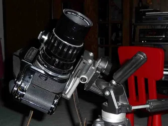

Mine is mounted on top of fairly stable 3 way pan head...

Yeh... it does say mini but it sure looks like mine. The one I have is pretty compact but should be strong enough for a 5dMII +MPE... (see photo attached)
Its pretty dang strong for its size... completely made of metal.
