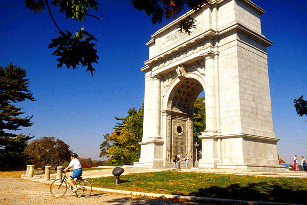

I want to get some pictures of this thing at night
Anyone got some advice...I have no idea what I'm doing (I did sign up for a class but thats a few weeks away)
