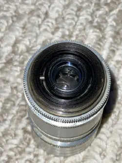

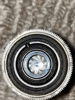

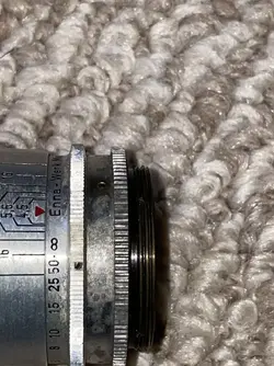

I iKokomo TPF Noob! Joined Jun 11, 2011 Messages 145 Reaction score 6 Dec 3, 2021 #1 I was just wondering what adapter I would need to use an Argus Tele Sandmar 100mm f4.5 on either my Nikon (F or Z) or M4/3 camera? What mount is this lens? Thanks!
webestang6463 Been spending a lot of time on here! Joined May 15, 2013 Messages 3,416 Reaction score 2,452 Location St. Louis, MO. USA Can others edit my Photos Photos NOT OK to edit Dec 3, 2021 #2 I think that is a screw type C mount. Nikon adapter.... FotodioX Mount Adapter for C-Mount Lens to Nikon F-Mount Camera
I iKokomo TPF Noob! Joined Jun 11, 2011 Messages 145 Reaction score 6 Dec 3, 2021 Thread Starter 🔹 #3 It is not a C Mount adapter as I have a lot of those and this does not fit on it. This mount has a larger diameter.
webestang6463 Been spending a lot of time on here! Joined May 15, 2013 Messages 3,416 Reaction score 2,452 Location St. Louis, MO. USA Can others edit my Photos Photos NOT OK to edit Dec 3, 2021 #4 Sorry, the one I posted is the 25.4mm C mount. The mount must be the larger mount at 33.5mm. Not sure if there is any adapter that size.
compur Been spending a lot of time on here! Joined Mar 6, 2008 Messages 3,963 Reaction score 901 Location L.A. Dec 4, 2021 #5 That's the Argus C3 mount. This eBay seller has an Argus C3 mount to Fuji X and M4/3 adapters and maybe others. RareAdapters.com | eBay Stores As an eBay Partner Network affiliate, we earn commissions on qualifying purchases.
