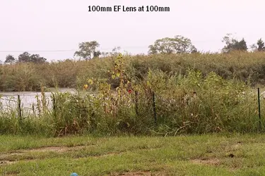

Ok, let's try this one more time. There is a common misconception that when you put a XX mm focal length lens on a crop body camera, you can multiply the XX by the crop factor, fooling yourself into thinking you have a 'greater' focal length lens. This is simply not true. Here are two pictures, taken on my crop sensor 50D. One was taken with a 100mm EF lens. The other was taken with an 18-135mm EF-S lens, but EXIF info shows it to be at the 100mm focal length. Both images have exactly the same field of view.
Now, here's the kicker. If I put a 100mm+ lens on a FULL FRAME camera, and set it to 160mm, it would show just about exactly the same field of view ON THAT FULL FRAME CAMERA, as both of these 100mm lenses did on my 50D.
That's the "crop factor". I know, it kinda sounds backwards, but that's because the camera companies tried to pull a fast one on the consumer when crop bodies came out by telling you that you'd have a 'multiplication', or 'telephoto' lens automagically appear on your crop sensor camera. That is not true. The crop factor is only in play WHEN COMPARED TO A FULL FRAME CAMERA.
This has nothing to do with the mechanical differences in the construction of an EF-S lens versus an EF lens, and they have nothing to do with the differences in sensor size and image circle.
Please, look at these two images. They are both 100mm focal lengths. The 100mm focal length lens does not look like 160mm on a crop sensor body.
