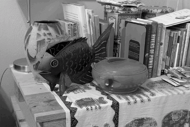

It will not. If one of the lenses you use is poor quality and full of distortion that could show. Use good lenses and the object photographed will appear the same in both photos. In the illustration below I used my 58mm and 40mm lenses on a FF Nikon Z7. The cropped image from the 40mm lens aligns with the image from the 58mm lens nearly pixel for pixel. The object photographed is the fish. I didn't bother to match the DOF since the topic is perspective, but that would also be possible.

I wonder what causes this?
Distortion in the optics and/or software correction thereof -- lens correction profiles.
I thought this was an example of how the two images would be identical. I guess I misunderstood.
Had you read the post you would have read the comment; "There are at best subtle differences and those are due to the software lens corrections. There is nothing in the way of a visible difference in these two photos that is a result of the different focal lengths." To get the two different focal lengths for the test I had to use the normal zoom lenses for each camera and set the two focal lengths. It's an adequate illustration to show the perspective is the same, but zoom lenses aren't going to be that well corrected. I did note the subtle differences.
