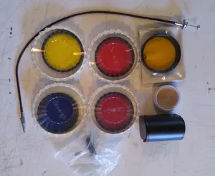

I was at an estate auction to buy some lenses, and I got this Large format that I wasn't planning on. It has the hard case, original tripod, and some filters.

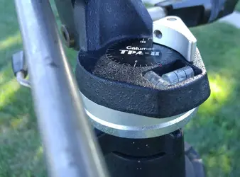

Nice tripod. I'm not too in touch any more with values but I think your $300 to $400 would be a little low however there's that fungus.

The tripod was luck, I hadn't paid much attention because I have tripods. But I started thinking that my brother has been filming some YouTube videos and has been using my tripod, so I bought this one on a whim. I didn't even know it went to the camera until I got home! LOL I wouldn't want to go too far hiking with it though, it is a heavy bugger!
