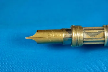

Both are 1600 pixels on the long side (thumbnails displayed). One is 100 DPI, the other is 1200 DPI.
Older projectors (and probably some newer ones) are terrible for viewing high-definition images.
Studio 101 is quite right; I know that a specification for dpi is often quoted as being required but it is totally irrelevant.
This is NOT relevant; they would have looked EXACTLY the same if the dpi had been change to some other value provided that you didn't alter the pixel dimensions at the same time.
