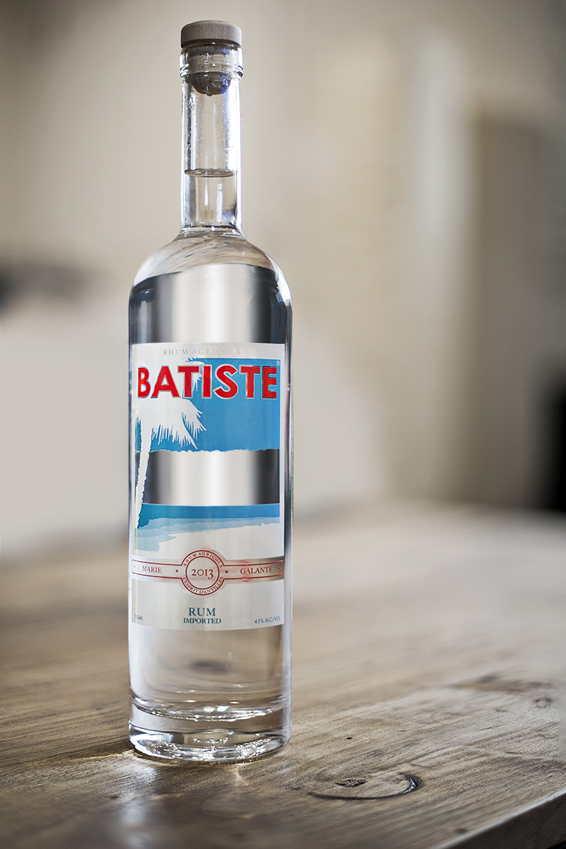

Here is a 4 shot stack of a new rhum. They would like to use some similar pictures on a webpage.
Batiste Rhum by keips66, on Flickr
Anything that could be done to improve it? I know that the reflections in glass can be a *****, and this was shot on my coffee table with natural light, and the philips hue set to a nice white tone for ambient. Some photoshop work to eliminate some really obvious reflections that did not belong. Thoughts?
I like it. Clear, can see the edges off the glass, and I love the color of the table. My gripe is with the background. The big chunk of blue/black is rather distracting, and I wish the background was just one solid color.
Jake
Had the same comment.
I wish there were a shot glass in this photo...
Batiste3-edit by keips66, on Flickr
Better?
I thought of adding a shot glass, but they really only wanted the bottle itself. Also, Im not sure you would shoot good rum like this. I think this is more for high-end cocktails. Which, hopefully, will follow shortly...
Better?
Much better

Couple more...
Batiste1 by keips66, on Flickr
batiste4 by keips66, on Flickr
^sort of an art deco feel to it. - not intentional, just a interesting mess-up:)
I think the color scheme and composition are a bit bland. I would add a glass, preferably the kind they use for Daiquiri cocktail - http://0.tqn.com/d/cocktails/1/0/q/J/-/-/margarita-002.jpg - it has strong diagonals, so you could put it behind the bottle. Cut a lime in two and put it strategically so it could balance the composition and add some bright color.
PS OK, I read about the clience request.. could you find some nice colourful fabric, put it on the background and blur it?
^Yep :) thats a good idea. This was a sort of preliminary shoot. Ill try it!
Now Ive been asked for an even simpler backdrop. -like white. Argh. I have a smooth white vinyl backdrop but im still worried about light and the reflections. Ill give it my best. Any pointers?
One old trick for shooting bottles and glassware is to make a reflector that is stood up or taped in place and propped up right behind the bottle. One suggestion might be to move back a few feet, to a slightly cleaner spot on the table, with no knots in the wood, and so on. Looking at the sample in post #6, I can see the burn ring on the table, and then through the bottle, can see what looks like a knot in the table through the bottom part of the bottle. What I think makes this table shot work is that it looks "real"...not so "studio", but more, well, real, and everyday living, kind of a casual,light,airy feeling. Apparently,somebody wants to see it shot in a more "controlled environment", with a plain white background. A plain, white background with no other props really risks becoming dead, lifeless, and sterile, and then you're going to lose the "view" seen through the bottle. If the background is shifted to plain white, then it's going to fall to you to create "some kind" of image behind/in the rum bottle, to create some kind of "presence" in the product.
^my thoughts exactly. They love the shots so far. But also want a sterile version. I was considering bouncing the light around a slit in-between some white fomecore and a seamless white vinyl backdrop. the only problem is I have one speedlight. I may have to borrow another...
Don't forget to leave room in the image should they want to put print in the ad.
