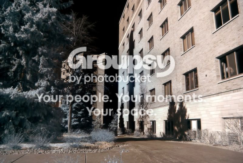

here's an example of one of mine. Also, i've never gotten a blue look to my photos, its either purple (auto WB) or i can get sorta surreal colors but the trees and stuff are never a color where they would turn whiteish and the sky would turn blue if i flipped the channels....
this one includes the wierd colors, i'm not sure how to do manual white balance on the Alpha without actually changing settings, is there just a way to go in and set it like you said? if anyone knows...
