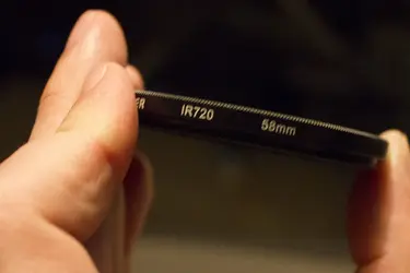

Wait. So not even an Bandpass or Highpass filter was used? You can sort of get IR without removing the filter on the sensor, but you need to filter the visible spectrum first and provide a long exposure.
I used a 720nm visible light filter when taking the source photos.. The three shots I stacked for the initial image (the one room school house) have an agregate total of 55 second exposure. Many DSLR cameras can still "see" IR even with the built in factory filter over the sensor. You can test this yourself by pointing a TV remote at the lens of your camera and watching live view as you press a button on the remote. If you see a light flashing on the end of the remote, guess what.... your camera is picking up the IR light that is invisible to the naked eye.
So please, before you call me a liar (which is exactly what you did in essence), have half a clue as to what you are talking about
Just to take it one step further... Here is the filer I use:
