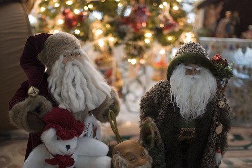

Ok, I went up and played for 5 minutes to come up with this for you. Since I do not have kids, and the dog is sleeping and wouldn't cooperate, I was forced to use my tree and a few Santa statuettes.

2 - Again, all natural light but this time you are focusing tighter. The aperture is open a lot more. Forground is in focus, background is blurred:
Becuase the aperture is opened a lot more, you need to make sure that all the poeple that you want in focus are very close to the same distance to your lens. Anything in front or behind will be blurred (as you can tell by the tree in back). This picture will be a bit easier to take, becuase the aperture is near or at wide open, the time it takes to make the picture drastically drops.
