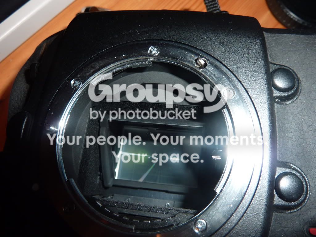

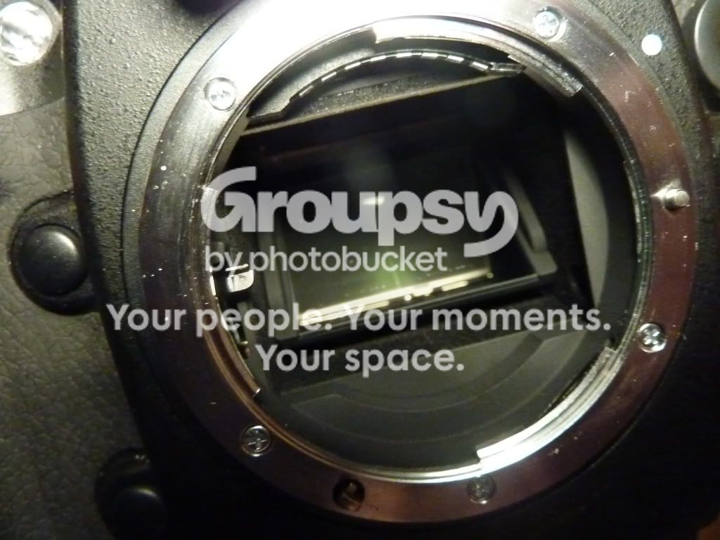

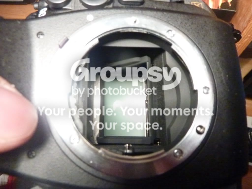

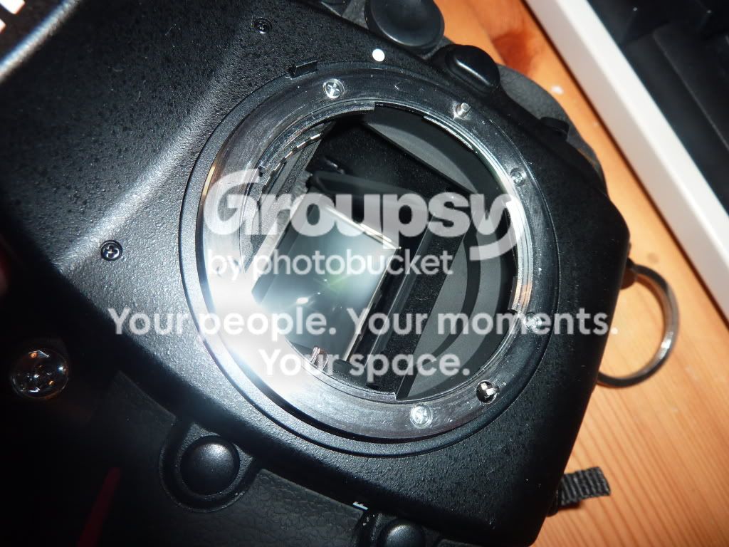

my D700 is less than 1.5 months old, about 500 shots and there is a line on the mirror. Is it a scratch or result from the impact due to opening and closing of the mirror? I have never touched the mirror or anything.
Hard to tell from here. My guess is if you never touched it then i doubt it's a scratch. Even if it is a scratch, it won't show up on the photos, the mirror pops up out of the way when a photo is taken so i wouldn't worry about it too much...
I know but, I am keep on wondering how that line got there, the line is perfectly parallel to the side, so my guess it is from the impact?
I can't tell either... Does it bother you any real way? Do you see it in your viewfinder?
If it is scratched, it will not affect your images. It will only affect what you see in the viewfinder.
Myself....... I would simply clean the mirror. If it's a scratch, no harm done. If not, I've cleaned whatever it is off.
The mirror is suspended by a fairly light weight, delicate mechanism. Be very gentle when cleaning the mirror. I have never used anything but a natural bristle brush to gently brush debris/dust off of mine.
Your camera is pretty dirty. I can see debris on the mirror and a lot of stuff around the lens mount.
Even a bristle brush can scratch the delicate surfaces of an SLR's mirror; that being said, scratches on the mirror are pretty much as harmless to performance as are the dead, dried-on insects on your car's front bumper...mirror scratches basically do no harm. Don't touch the mirror with anything: blow it off using a squeeze-style air blower.
I agree to Edsport, Without seeing it, it is quite difficult to say whether it is scratch or not.
If it's only a month and half old shouldn't it be still under warranty? Get them to see what is going on...
Use the dry lens tissues, fold them and tie the onto something so they have a flat surface, soak them in 70% isoprophyl alcohol, and from the top going down move the tissue across. than immediatly get a dry tissue also folded, and banded on a stick of some sort and run it over in the same motion again. I cleaned both mirrors on my F100's like that one time when they were super super dirty, works great and doesn't scratch.
