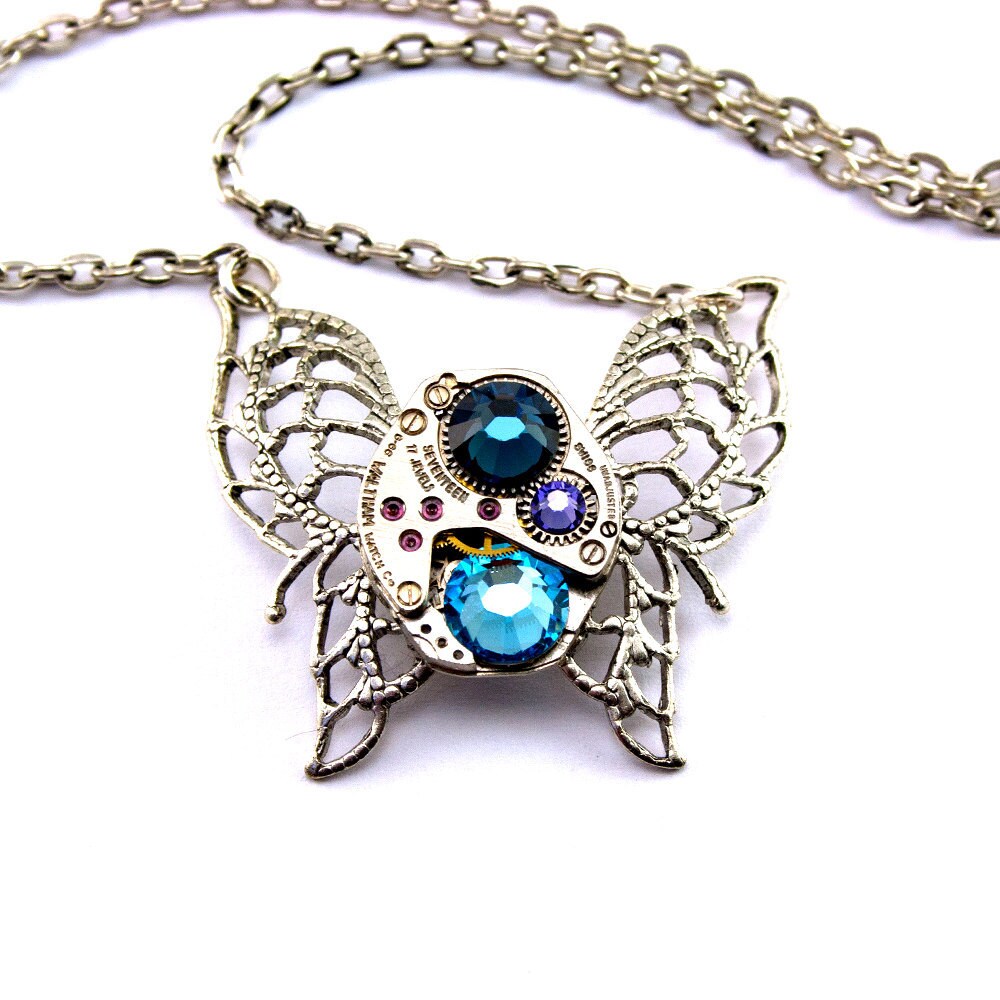

I am attempting to capture an image with good focus such as this photo http://img3.etsystatic.com/il_fullxfull.299087647.jpg
I know it is a necklace, but this image was produced with the standard 18-55 mm lens.
I am trying to reproduce the detail. I have a light-box (purchased), lighting is not the issue as are the settings. I have been using f11 and settings seem ok, problem is I am having to do a lot of editing in Photoshop.
