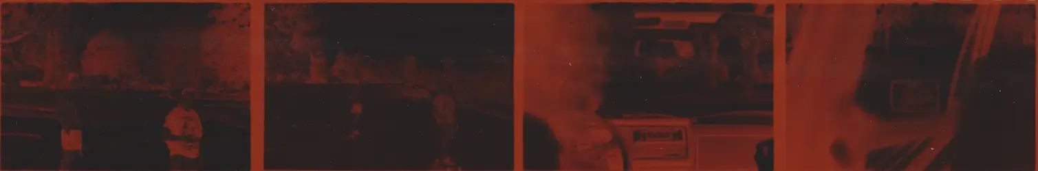

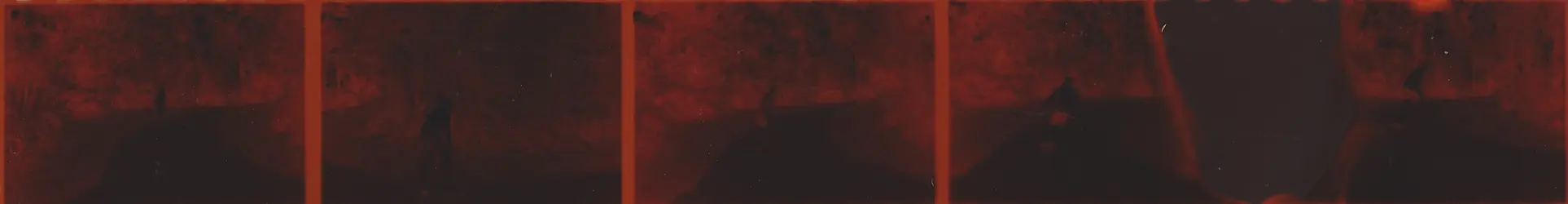

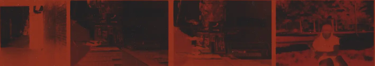

wondering if anyone else has used this combo yet and if they have any tips. developed my first roll today and it seemed ok, (could see images on the negatives) but once I scanned and attempted to invert the images the photos were mainly blue and white. I followed the cs41 kit's temps and times just with constant agitation instead of intermittent. could my issue just be how im inverting the images? or is adjustment to the process required, (i was slightly put off by 8 minutes of blix) ill attach the photos i have of negatives if anyone would like to attempt to invert them.

Kodak ColorPlus 2oo
Sure has a heavy base fog. Base should be a light orange/reddish color.
What could i do next time to ensure the fog doesn't happen again?

One other thought, was that fresh film or expired?
the film was fresh.
What program are you using to scan the negatives?
the film was kept at room temp as much as i can remember. If it was it wasn't for longer than an hour or two. I just used our printer/ scanner to scan the negatives
How did the pictures come out? =]
i haven't been able to get pictures out of them
You can't really use an office printer and scanner. You need a dedicated film scanner.
