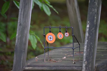

I admit to having seller's remorse about my 25+ year old Nikkor 300mm f4 ED to replace it and my old 70-200 f4 with a 70-200 VR-II 2.8 & 1.7X teleconverter.
Now, I see that the color from the old lens was better: BGD_3414
So, as I prepare to sell the Nikkor 70-200 to buy a Sigma ART 85, I am concerned that the many elements used to make it super sharp, may not give the color I want from a prime that I enjoyed in the 90's.
See attached photo from my Sigma 150-600 as comparison.
Sorry, I did not post an example from the 70-200 VR-II with teleconverter about which i discuss here. here is an example of that combo: GEO_0743.
My current coverage for 300mm is my sigma 150-60o.
So many tests, but such little discussion about color rendition.
All discussion welcome. this post is not so much meant as a request for help as a foundation for discussion of lens color being compromised for other trendy aspects, like sharpness

as an engineer, i agree. free discourse is invited. i am pretty pleased with sigma color, tho
these are lovely renderings, but the notion of 'true' color seems a little strange to me.
