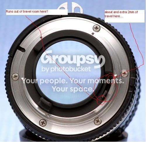

I bought a Nikkor 50mm f/1.4 AI-s lens the other day on ebay
and i got it in the mail this morning.
everything about the lens except for one thing looks great
focus is smooth, no scratches, dust, fungus, haze in the lens
aperature ring snaps nicely. However i was looking at the aperature
blades to make sure they were nice and everything appeared fine
until f/11. the aperature blades do not appear to move between
f/11 and f/16. My question is, is this a cheap fix, or do i send the lens
back to the seller. I dont mind spending a little to get this fixed, but anything
more then 20 bucks and i might as well send it back and look for a different one.

ok, so i got home and i looked over the lens very well.
The aperature blades do not move from about f8 and 1/2 to f16.
the aperature hole appears to be fine nice and round, it doesnt look like any of the blades are sticking.
I then looked at the coupling lever. this comes out of the back of the lens between the mount and actual rear element. There is a little slot that this lever travles in. wide open there is about 2 mm of travel distance from the lever to the top of this slot. as i close down, the lever moves along fine until i get to f8 and 1/2 At this point the slot that the lever moves along in ends.
In the discription of this lens, the seller said that the lens had been serviced by a professional. I am wondering if this means the rear element was removed to get at the aperature blades and when the cover was put back on this rear element was rotated slightly, even 1 degree might be enough.
anyway what that means is that there is extra travel (ie more space for the coupling lever to move up) even when full open, but because of this there is not enough space for the coupling lever to move down thus preventing the blades from closing all the way when i go to f/16
Does this sound possible?
anyone?
here is a picture to show you what i mean
If the problem is as you describe, you may be able to fix it yourself - have you tried removing that rear holding ring?

i talked with the person i bought it from and it sounds like
she had it serviced by a repairman who cleaned the aperature
blades. my guess is that when he put the rear cap back on
it got turned just a little. I might try to fix it myself
or i will have to wait till tuesday for the local shop to fix it and
i dont want to wait that long
