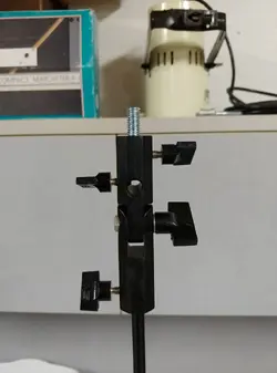

Well today I ended up making my own adapters. I was hoping not to have an adapter hooked to an adapter, but it works and I get a few more inches of height out of the stand. I only have 2 of the original adapters, but I only have 2 speed lights along with my new strobe and stand.
I took the 1/4-3/8" stud out of the new adapter pictured above. I then hit the nuts/bolts bin in the shop looking for something that would work. Turns out that a 3/8" bolt is threaded right for the stud and the shaft is the right size to fit into the original adapters I had. I took the sawzall and cut both end of the bolt off, after measuring of course, then cleaned up the edges with a Dremel.
You can see the stud sticking up from the original adapter
Here is it all assembled with the new adapter attached on top of the old one
