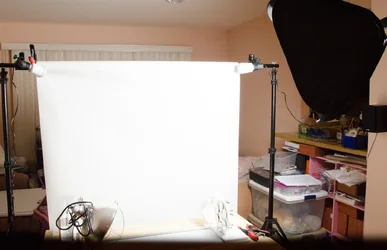

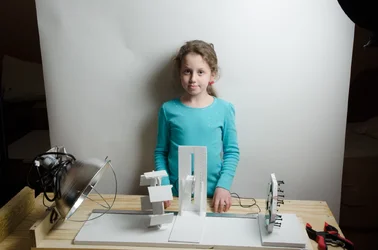

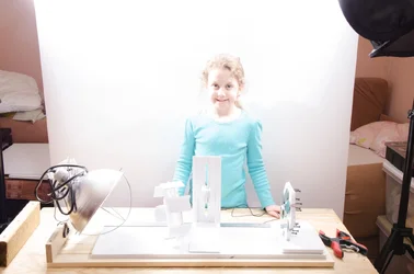

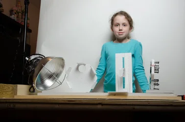

Ok back for more education. Setting up backdrop and trying to play with some slave flashes. As usual I am doing something wrong because I am totally blowing out everything. When slaves fire I get this. When just the off camera flash fires I get this. And the set up is this. And all I am looking to do is fill in the shadows and get some even light going. So as usual thank you for explaining where I am making idiotic mistakes. :).
Specifically where in the world those slaves should point and where in the world that off camera flash should go.
PS the best I could get was the last one.

First of all why are you at ISO 800???? 2nd I think the max synch speed for the D5100 is 1/200 not 1/250 but I may be wrong on that. Still you have a lot of room to slow it down. I'm assuming you don't have a light meter to set your lights, so simplify the set up. There's others more qualified on directing you that will hopefully chime in, but to get you started here's a suggestion. Do away with those back lights. Lower your softbox height slightly, and use a large white reflector on the girl's other side (camera left), angled to bring light back in on that side. Switch your camera to full manual. Set your ISO to 100, set your aperture if possible to about F/8, then adjust for ambient light to about 2-3 stops under. You might have to open the aperture slightly if the shutter gets to slow (say below 1/60). Take a test shot, and evaluate, look at your histogram and adjust your aperture up /down, adjust the power level on your softbox, or both, and try again. The ideal histogram will show a bell shape tapering to each side, but not extending up either side. Once you've mastered this type of lighting - then start to add back your other lights.

Do I keep that softbox at 45 degree to the subject or bring it to the front and just turn it 45 degrees?

Think of your floor as a clock, if the girl is at 12, ando your camera is at 6, then move your softbox to about 5, pointed at the girl, slightly above and angled down slightly. You will need to play with the reflector location, but somewhere between 7-9.

DC_051.jpg looks good....f/11 at X-synch speed of 1/200 second...the background attachment shadow "places her" in front of a seamless backdrop.
Not sure what you want to get, really. if you want s clean, white background behind her, I would put a slave flash aimed straight back at the papper, at her mid-back height abnd about 3 fet behind her.
One big issues is using a wide-angle lens from TOO CLOSE--this is caudsing a wide anglke of view behind your daughter, and the foreground science proiject is "running off the paper:.
This would be better shot from 2x the distance, and a longer lens length. DSC_051 was shot at 32mm focal length: it would be far better to move the camera farther away, and use the 50mm end of that 17-50mm zoom: that would narrow the angle of view BEHIND her....and would "keep the shot on the background paper".
The first shot is wayyyyy over-exposed. As SMoke mentioned--stay away from AUTO ISO and stay away from 800 ISO if the shots are too bright.

What kind of slaves are those? How do they fire? Is there some kind of adjustment to the power level? You say the softbox is at 1/8 power, but those slaves appear to be at full power. You probably need only one of those on the backdrop.
Double check all your settings, including the shutter sync speed and the ISO. If you have any more available space, move your subject away from the backdrop. Set your camera at about the height of your subject's chin.
Lacking a light meter, you can set each light group separately by doing test shots. No model at this time, just get the lights right first. After you get the lights adjusted, call in your model.
Thanks designer those are JTL 1010-S25Ms They have a light sensor I guess so they fire when the speedlight fires. I was trying to use them to eliminate the shadows my guess the are too bright for the purpose. Back to experimenting.

Ok I understand now. With an output of 25WS they were not the cause of blowing the background. That was likely caused by incorrect exposure settings. However your use of them was also wrong. As Derrel suggested place one behind her pointed toward the paper, and would suggest a modifier on it as well (softbox or umbrella). I would still suggest you set up using just your softbox and a reflector until you learn how placement, distance and intensity will affect your exposure.
