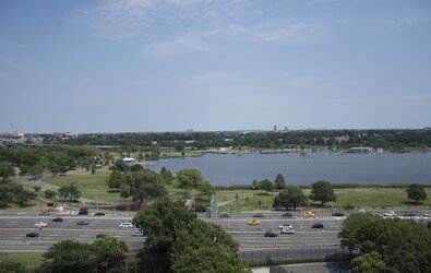

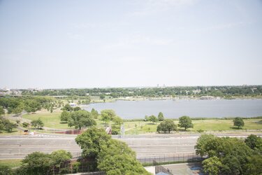

File uploaded with no filter 1/1600 iso 100 F11 and also with filter F18 4" 100 ISO (much Brighter photo)
Without your filter, what was the settings for good exposure?
For your question: "Without your filter, what was the settings for good exposure?" 1/1600 iso 100 F11

You went from f11 to f18. This is ok but complicated the maths.
1/1600 sec at f11 iso 100 without filter is approx 1/2 sec with 10 stop filter. F11 to f18 is a little over a stop again, so your shot should have been approx 1.2 seconds with filter to be exposed like first one without filter. 4 secs as you saw over exposed it.
I'm still dodgy as to being at iso 100. Are you def it's not in auto iso throwing things. If for example it's as I said with similar sunny day settings of f11 1/250 and iso 100, the ten stop should give you 4 sec exposure. If you want longer you can close you aperture to f22, or add another filter, or better still take this type of shot when the light is less, early morning or later evening
