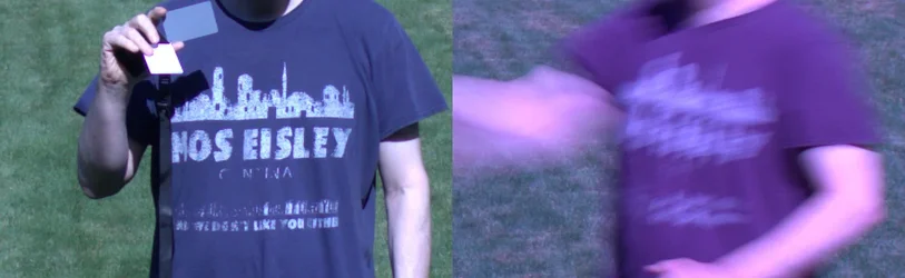

I took two photos of myself. First I was standing still with a gray card, in second one I was throwing a ball in the air to get a blur. I used ND filters for latter.
F/7.1 for both
1/500 for first, 1/8 for second.
I find longer exposures tend to be reder and short exposures bluer. I used white siding of nearby house as white reference in second image. Still don't quite have equal exposure but mostly I'm concerned with my blue shirt turning purple in longer exposure. Why might that be?
Ultimately I'd like to be able to superimpose a still person in front of a moving background, but need to normalize colors in both.

Many image editing tools have a white balance picker, that allows you to select a point in the image to make neutral.
If you used the same siding as WB on each shot (the second through the ND filter) the colours should match. Do be aware that ND filters are never totally neutral, the better ones might be close, my cheapest are WAY off (but they don't actually claim to be ND filters)
Instead of using a filter try lowering the ISO and upping the F-stop for the blurred motion shot. Maybe use a telephoto lens on a tripod to create the blur if you can't get the shutter speed low enough.
You could also set for auto white balance and have the same white object in both shots in case you need to edit it in post.
As everyone said filters introduce artifacts, combining shots of with and without will be tricky to get perfect color match. You may have no choice depending on what you're shooting, in that case a good post editing software is where you will have to work.

White balance selectors work as well on white card as gray card?

Has anyone created a true ND filter? Why the coloring?

No, because it's impossible to get it perfect.
Many filters are made by mixing dyes and however much effort is applied some residual hue will remain, in addition this may vary slightly from camera to camera.
I gather some are made using fine metallic particles, which means they also block near infra red (which goes through most dyes) These will probably be more uniform but will have slight tints for impurities etc.

They should do as long as none of the channels are maxed out. I've used white paint on the side of a race track to correct white balance. For infrared work it is common to use foliage to set white balance, though concrete, skin, PTFE, clouds and no doubt many other materials are also used.
All a software base white balance does is look at the relative strengths of the three channels & apply corrections to make all three the same. For artistic effects white balance can even be set on distinctly coloured parts of an image.
The benefit of a grey card is that it's designed to match the 18% grey that camera systems try to aim for in exposures.
