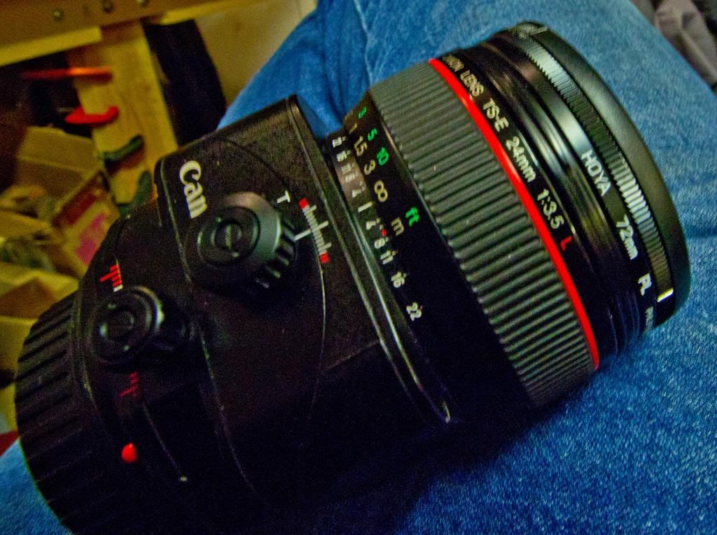

Then maybe you could help me ?
I have been shooting in manual focus with my 5Dmk II for about three years.
I have all sorts of buttons and nobs on 2 of my lenses and yet can figure out how to set them to AF..
So which one of these nobs turns the lens to AF ?
I would never want to use AF for landscape, or still product photography.
If the camera body is on a tripod and its still photography I am in MF.
And normally I am tethered.
I don't have any issues using a TS-E 17mm F4 L lens free hand, and have (never seen one that has a AF motor's ) <<<<<<<<<<<<<,
